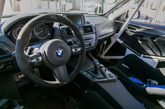

    Perhaps the most controversial decision was to retain the production ZF 8HP eight-speed automatic transmission, not even offering a manual option. According to Jens, the decision was taken during the development of the BMW M4. While driving test mules on the Nurburgring, BMW management and engineers felt that the speed and simplicity of a paddle shift would make the car more accessible to a broad range of drivers. It would also protect the engine from over-revving, and wouldn’t add any development cost beyond software. It also transpires that ZF was very keen to support the project. Despite the sound of straight-cut gears from inside the car, we’re assured this was the result of no sound proofing and that it’s internally stock. It even keeps the same ratios as the road car. What is different is the shift speed, engaging fast and hard. The torque converter is disengaged once the car’s rolling to prevent it slipping the power after shifts. With this transmission, the car is like driving the E60 M5 with the shift force turned up to max – it comes in with a bang.
